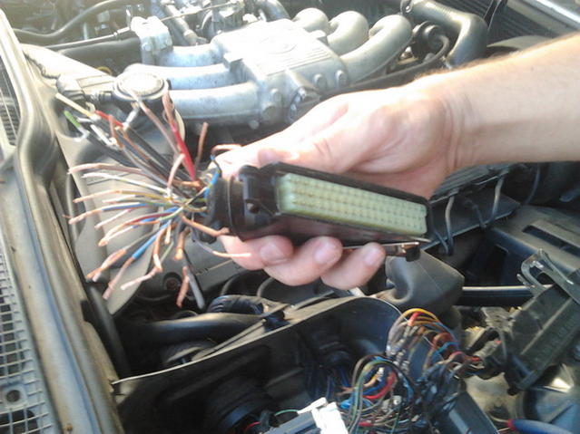

    This car was previously 535i m30, but now I installed the engine m20 2.0 with the 4hp22 automatic transmission. While it was m30 it had the ASC along with the ABS, but now when I installed the engine I tried to replace the ECU of the ABS but the connectors didn't match, then I replaced the connectors but then I got some extra wires because I replaced the connectors by matching the colors of the wires, but now I got some extra wires and my ABS doesn't work. Does the ABS affect the ECU of the transmission? My kickdown knob is still under the accelarator pedal. The ECU of the transmission receives power but it may not receives the input data of the engine which is vital for functioning. How can I revive the transmission and what I need to do make it work? Do i need the return the old ECU of the ABS even if it didn't work because this engine has no ASC?Do I need to connect some other thing which isn't in the M20 electric system?

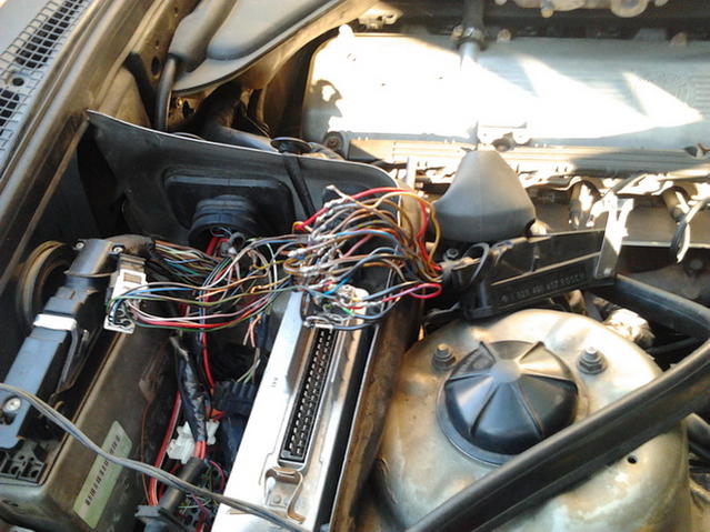

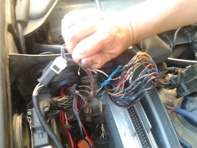

    On these pictures you can see that I'm putting back the other connector for ABS and the whole ABS module. As you can see on the small white connector the wires are cut and they give the signal to the ECU of the transmission. ABS won't function but it may give the necessary data to the ECU of the transmission to make him work. Is this a possible solution? Any other suggestions?

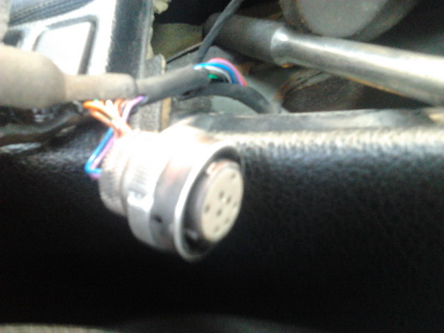

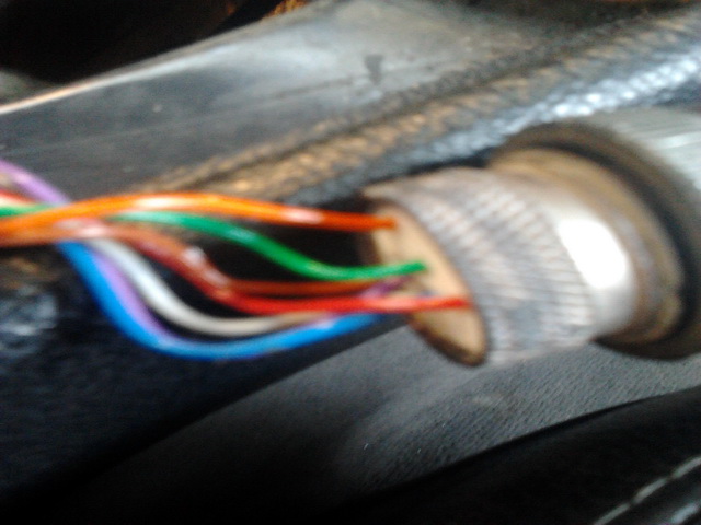

    Today I quite coincidentally noticed two little connectors, one with two pins and one with three pins. Then I remembered that the car had cruise control, but the module or whatever was there, was dismounted. I think that the couple of wires from these connectors also go the module of the transmission. Does this affect something? If it does can I somehow fool the ECU of the transmission that I still have cruise control. So, my point is that I discovered a couple of connectors which were on the cruise control, and now on M20 I don't have that. It seems to me that the transmission was receieving some data from it. What can I add to the transmission and what are the key input data to make it work?
