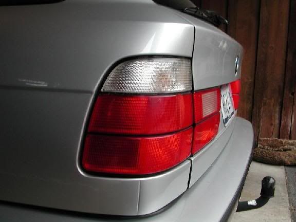

    oem sub panel to left of changer
    horsecock for the westfalia oem tow system.
    adapter for US 4 pin trailers
    You want this oem intergrated tow bar set up from westfalia because you can take out the horsecock and put a simple cover over the opening when not in use. It also can save your shins when arms are full of groceries.
    I have the manuals at the office I have been meaning to scan, and if someone would remind me, I'd post them, or fax them to you (about 9 pages)
    I promised W Zareska I'd pull apart the insulation and take pictures of how the subpanel ties into the harness, because he trying to get that subpanel in his Limo, and is having difficulty.
