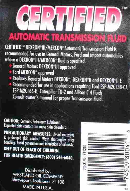

    Default One more question -
    the 5HP18 in my 530 calls for Dexron III or Mercon - not Mercon V.
    I want to do several drain/refills and found this for 0.93 cents per quart.
    Any reason I should NOT use it?

    Default Mercon v is the
    newest generation of the dexron II,III, IIE , Mercon line, Its specs are here
    I would use a known brand myself, the cost difference isn't that much. Chevron and mobil go on sale here frequently
