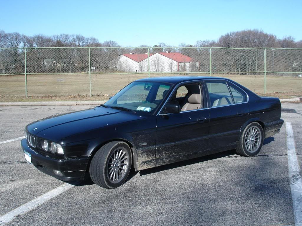

w.wwait......you guys.....clean your cars?;)
http://i140.photobucket.com/albums/r...GERM/dirty.jpg
