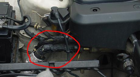

1 Attachment(s)
Insulation Fix?
In the engine bay on the passenger side, there's some pipes that are protected with insulation (A/C?). I've attatched a picture. This insulation is falling apart / dissintegrating. Does anyone have a good fix for this problem or should I replace the insulation (That seems like a bit of work). I appreciate any comments or suggestions. You guys are great!
you can try regular house pipe insulation but you will have to tape it sealed, try to get an inner diameter tight as possible.
I just ran across this stuff while looking for something else:
http://www.acsource.com/index.asp?Pa...S&Category=386
wow thats sweet! another bookmark...lol He will still have to slice it and tape it but it's probably much better than household pipe insulation.
Might be easier to slice it and zip tie it.
Home Depot should have the rubberized one there...
Are the circled pipes Air Conditioning?
Yes. The fat one is low pressure, thin is high pressure. More R12 fun facts: the fittings are the same on both sides.
best, whit

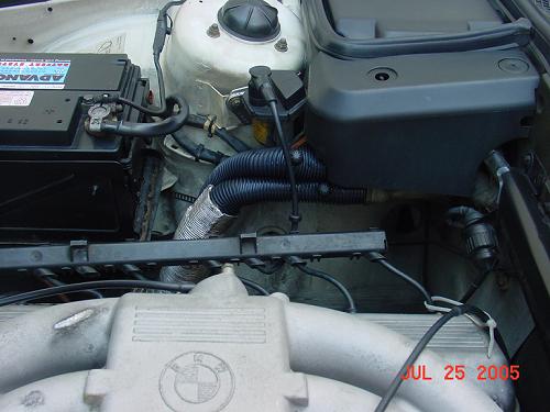

1 Attachment(s)
After Picture
Here's the after picture:
Wow- what a difference. Looks so much better than stock. Great Job!
