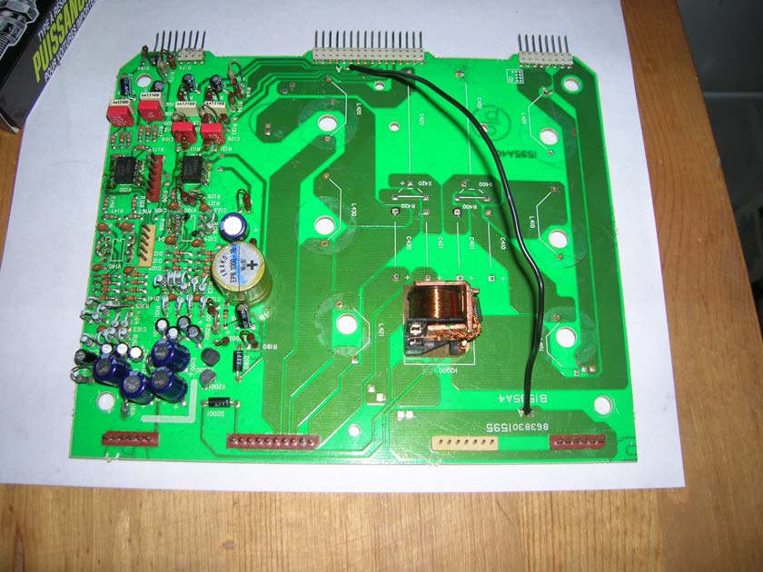

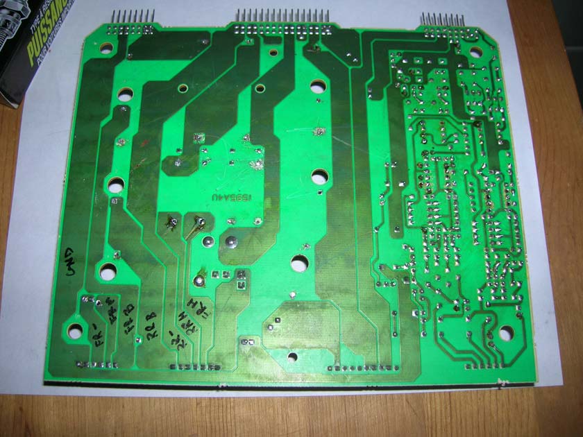

Well, I've seen how the negatives are wired. B4 and B10 get divided up between all 4 negatives back at the HU.
Before any negatives get onto those two terminals (B4 and B10), however, they go through a series of capacitors and a couple of resistors, which means that perhaps this sorts out the fade. It would be interesting to examine your PCBs if you still have them Tim. I'll perhaps try to figure out my own negative circuit.
First up, I'm close to completing my build and installing it by just splicing the negatives back to the front as is.
Well, whaddya know. It all works just fine, including fade and balance. I just have to kill the bass a bit, and treble too, and it all sounds very nice indeed. It does lack in the bass department, but that's already well known.

You can have my old pcb if you want it for research, i think i voided the warrantee on the amp -->:D
topside
underneath
if that's too easy you can try the eq ... soon to be scavenged for aesthetics!
