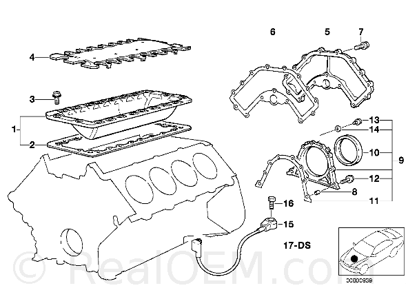

In case of my car it is on passenger side under the water tank.
http://www.realoem.com/bmw/showparts...84&hg=16&fg=10
Here a pic from my parts 750, at the left you see the round black cannister
http://img6.imageshack.us/my.php?image=bmw11261fd.jpg
Just found another pics from another 750 in my yard. here you can see it better
http://bmwe32.student.utwente.nl/shogun/DSC00005.JPG
Do you have an idea where number 6 leads?Quote:
Originally Posted by shogun
this one appears to be unventilated type.Quote:
do you know where the pipe at the side with the cap leads?
Any chance the pipe that runs under the manifold to the rear cover fell out? it can be tricky to get it all the way telescoped out and it can slip out later.
O ring could be sloppy, or the intake gasket popped out and is singing to you now.
