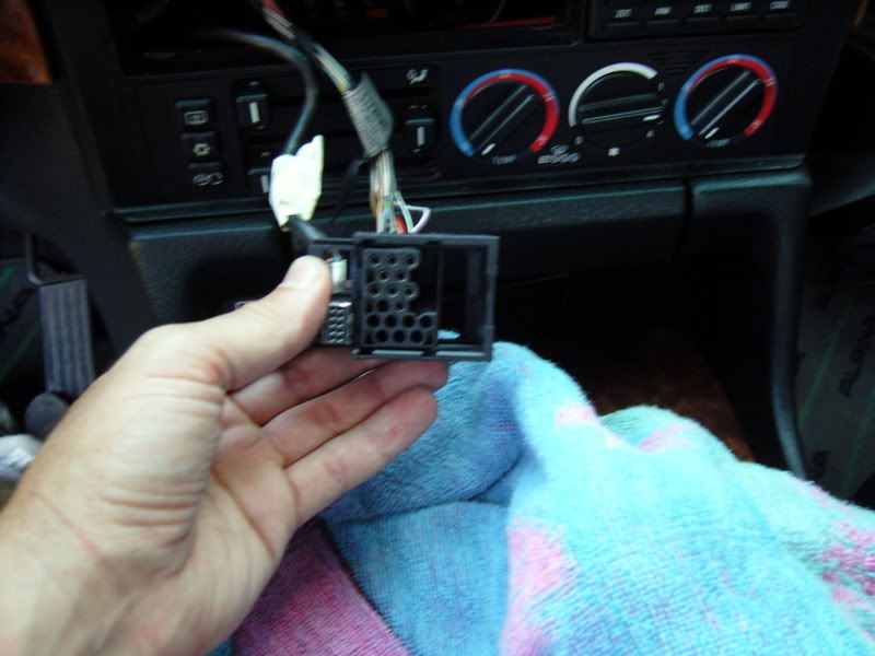

Am I way too late for this? I'm tired of trying to read my display with 10% of my pixels gone. I have a 12/91 build with the Bavaria C Professional head unit with RDS. Here's my connector:
http://i35.photobucket.com/albums/d1...g/SNC10248.jpg
Greg S.
