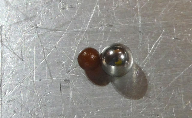

    ZF 4HP22 on a E32 735iA had no reverse, usually the problem is then the check ball lost (because it became too small over the years) or bypass main plate problem, forward and reverse change by check ball in main plate. Last week we replaced the ball on the 735, as you can see the valve body check ball deteriorated, too small like this. Pic new and old (smaller one)
