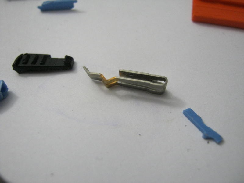

    I can't figure out where that metal thing goes. Nowhere online or anywhere else can I see where it would possibly go. It's almost like someone threw that in there just to mess me up. The copper color tells me it is electrical in nature so it should go in the crushed up end but it don't lol. Some sort of safety in case someone pulls the thing apart? Idonno.

    it goes like this.

    I need a new plug end to solder on and be done with this. I have no glue that will work on this plastic. My fingers feel like they are in a cast from superglue.
    Edit: I hot glued the connector together making sure not to fubar that mystery electric component above. What it does is ground the 2 airbag leads on the steering wheel side male connector.

    Thanks that's a much better pic, now I see what you mean...
    No magic fixes for that- I'd get a new connector though; a jerried airbag plug may void insurance and/or kill you driving!
