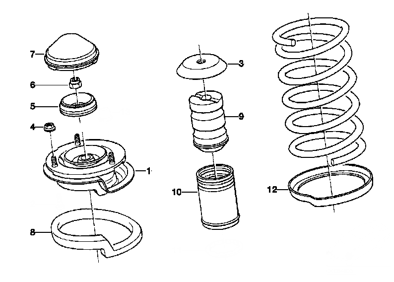

Don't need the bump stop as the billys have internal bump stops. But that spacer should've been in there. That spreads the load out over the strut mount to prevent the shaft from punching up through the mount.
When you posted pics of your mount I'd wondered if you'd left part of the assembly out. Guess you had. I've seen pics of rear strut mounts that someone had forgotten that piece in the rear and it did the same thing. Punched the shaft up through the middle of the mount in a rather short time. Now I've seen pics of it on the front mounts as well.
Who told you not to run that spacer in the assembly? I've never heard anyone say that.
