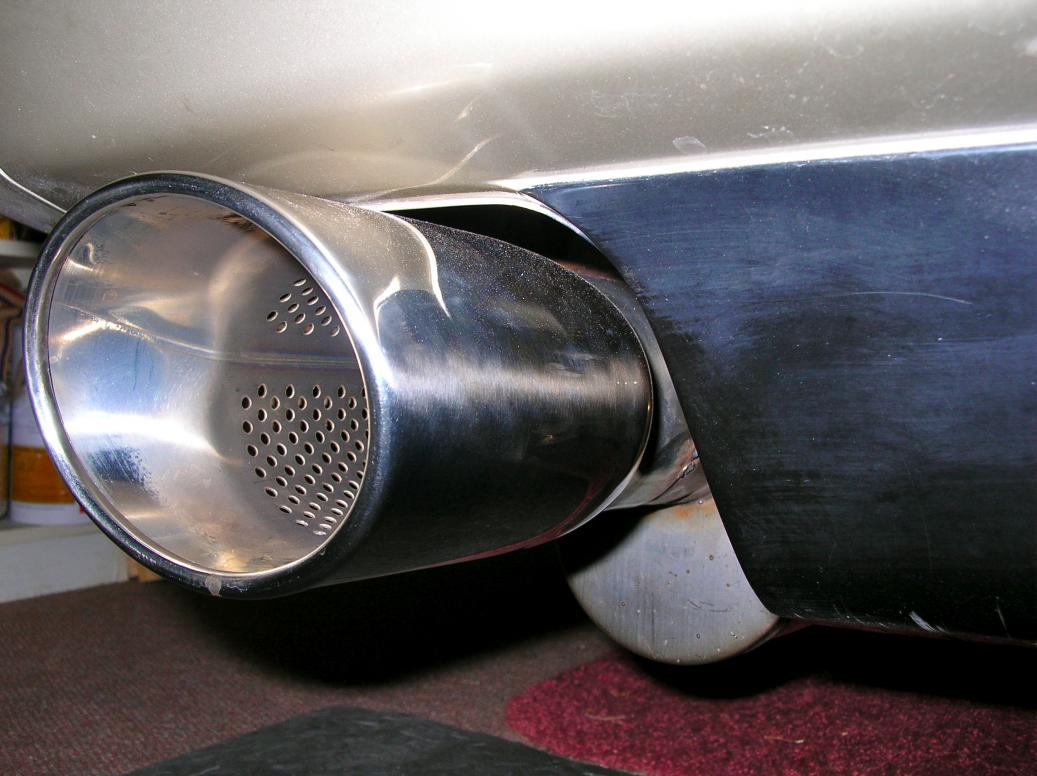

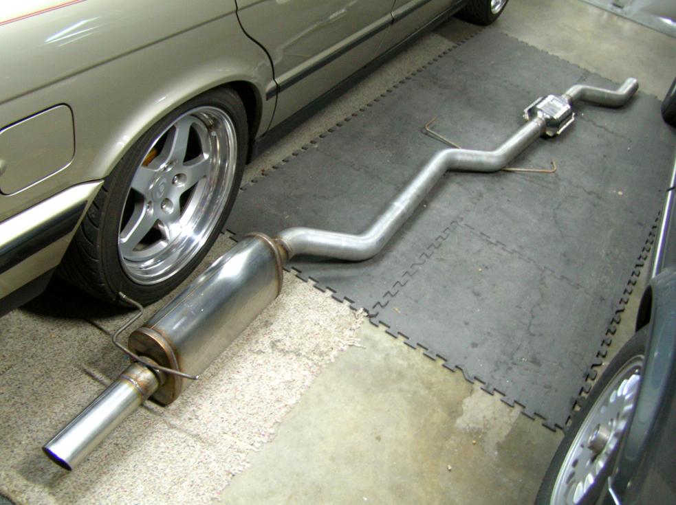

    The exhaust is in, sounds great, not to loud at all....
