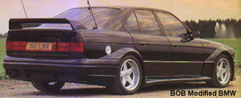

Originally Posted by tonytw34
is that your car? thats hot, more pictures!!
Originally Posted by Alexlind123
just for you angrypancake

Cool--another wide-body E34...Originally Posted by tonytw34
1995 540i 6-speed
3.45 LSD, 17" Style 5's, AC Schnitzer Steering Wheel, Momo shift knob
