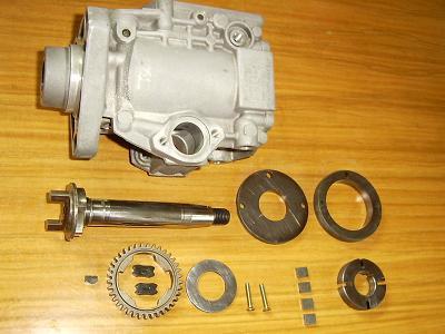

    These are the transfer pump components....

    1-Tis not really possible for an injector even if stuck open to allow air to enter and drain the whole pump back to tank as they are on a completely different hydraulic circuit within the IP, and the delivery valve on the HP line at the pump effectively seals the injector from the pump just like a NRV Most of the time, the line to the injector is closed off by the action of the pump plunger within the high pressure rotorhead as well--If for some reason an injector was stuck open, you would get a heavy knock on that cylinder with maybe smoke etc. as it would not be atomising correctly.
    2- You are experiencing worse starting under low tank contents/parked facing uphill, It really looks like transfer-pump component wear allowing the fuel to drain back from the pump past the worn transfer pump vanes/rotor/liner. Unless you are brave, I would recommend you take the pump to a Diesel Specialist and tell him the faults. It is possible to do the job yourself IF you can get the components,--Sometimes not easy as diesel specialists dont like to sell components for pumps--The main dealer will be even worse wanting to supply a complete pump only, as they dont stock internal pump parts.
