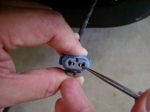

    Quote Originally Posted by liquidtiger720
    So, I bought some euro ellipsoids that I thought were a good deal. But you know what. I just remembered, I need to rewire my headlights with h1 connections!
    Anybody have a clue how I can change my stock 9006's to h1's? I can't find any of the links =x.
    Before you snip those stock 9006's try doing this (see pics) first. Enlarge the holes to make it fit the H1 round prongs. Do not overdo it. You want it to have a tight fit.

    Great Pictures. I've read that advice before "Enlarge the holes to make it fit the H1 round prongs.", but I've had a hard time really visualizing it. Not so now! Thanks!

    Quote Originally Posted by joreb0
    Awsome, Thank you very much. I may give that a try.
