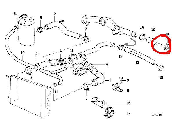

I will restore back the 85C therm. today I ran the engine to fill the battery again since it was off for 2 weeks. I started to suspect that blocking the heater pipes is playing a big role in stopping the circulation in addition to the t-stat removal. I attached the realoem graph of the water cooling system. I blocked the hose with the circle around and the inputs of the heater core pipes. actually this is where it keeps exploding and popping out when it heats. hope this can get me somewhere closer to whats going wrong. http://www.bimmernut.com/forum/attac...1&d=1213295198
Ok, unblock the heater pipes & examine it, some times it causes overheating issues, perhaps it has made some resistance in the water circuit leading to high pressure.
I'd suggest one more thing, check all the hose clamps precisely & also check the thermostat cover & gasket. some time faulty clamps wont leak water until it reaches operating temperature.
Are you Bleeding all the air out of the system? Very important with these cars, Can you stop the fan with a Newspaper? If so bad fan clutch.
connect the 2 hoses together instead of blocking them.

connected the 2 hoses, water seems to flow better, I also replaced the water pump as the pump was a little loose and I wanted to make sure all the cooling system is working again, I also restored the 81C t-stat. while installing the pump I put the radiator on the floor and filled it with a cleanning fluid contains Acid, as the radiator was contaminated with calcium build ups.
