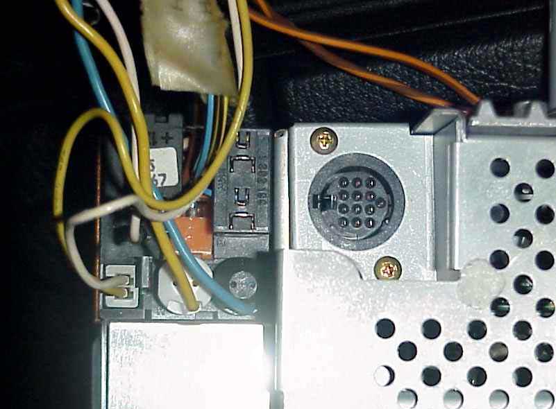

...THis is the way all e34's should be wired.
hmmm... that seems to be the consensus from everything i read, but i connected my jvc to the 4 positive AND the 4 negative inputs going to the factory amp and it worked waaaaaaaaaay better than when all the negative wires were tied together. i can use the f/b fader on my head unit, too.
i should admit i have some unsolved electrical gremlins, but i don't think the stereo is the cause.
there is a post here somewhere on how to bypass the amplifier in the factory unit and connect directly to the crossovers inside. haven't got around to it yet, but i am looking forward to it. still sounds ok for now through the factory amp, and i have plenty of volume.
