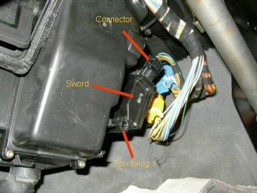

To remove the 2 screws which hold the sword in place you need a long T20 screwdriver, a small T20 bit is not long enough, as the screws and about 2 cm deep in the casing/hole of the sword. http://www.meeknet.co.uk/e32/BMW_E32...tm_files/9.jpg
Sword and filter removal DIY http://www.bimmerboard.com/forums/posts/54597
