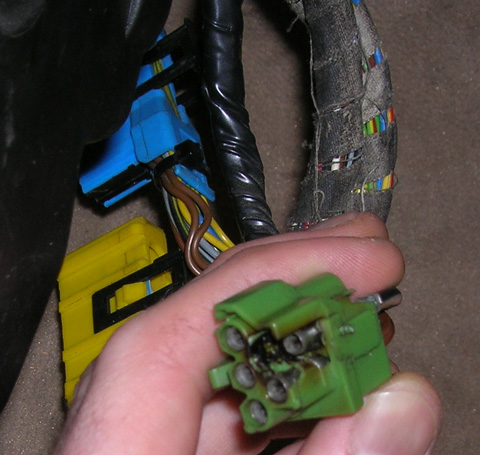

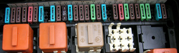

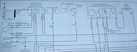

so i've been chasing assorted gremlins and found this short in the plug to the ihkr final stage unit. i don't think it's the reason behind my recent charging system problems but i'd like to disconnect it for a time all the same. i have pulled the blower relay and the #19 fuse in the main fuse box i think that kills everything but i'm not sure... advice please? am i leaving any open circuits?
that ground goes to g202 so i'm wondering if there is a short there too, first i have to find it!
