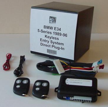

The keyless sytem I bought was to be connected to a 12-pin connector like this picture, located under th rear seat - passenger (Right) side.

I think I have that connector mine is below the black battery cable, it has a couple of wires already going into it but doesnt look like as many as yours, what keyless entry system did you use that went into this connector?Quote:

I bought it on eBay, it looks like this. Make sure you have the right connector if you're also getting one. The connector it's going to will be used (it won't be empty).
Ok I have that connector, now can I just go out and buy any keyless entry and it will hook right up into that connector? or what is the install procedure, I looked at the write up on bmwe34.net but it was a little confusing and long winded.Quote:
